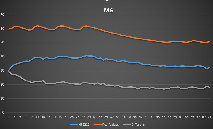

My company is using since more than one year a combination from HTS221 and stm32f407 uController , I2C is used.
The problem is that on some devices i have from the sensor different results.
also some sensors give correct output where the others give lower values, where both of them have the same circumstanses. like the same board design and the same uController firmware.
in the attachment there are the output data from two sensors.
I wonder where the problem could be?

HI @Eleon BORLINI​ , we have 10% failure rate in our sensors, and they failed since the beginning, we are now trying to know if we can solve this problem by adding our own Offset to the firmware, in the attachment there is the output data from a "bad" sensor.
it is obvious that the sensor is working but with a false offset.

-Sorry I did not explain very well, this information are from bad sensor, the blue curve is the humidity, and the red is Temperatur,
We put the sensor in climate cabinet at 21°C, and a tried to increase the humidity, the sensor has reacted well but with lower result.
We are now trying to find out the difference and solve this problem with our own offset.

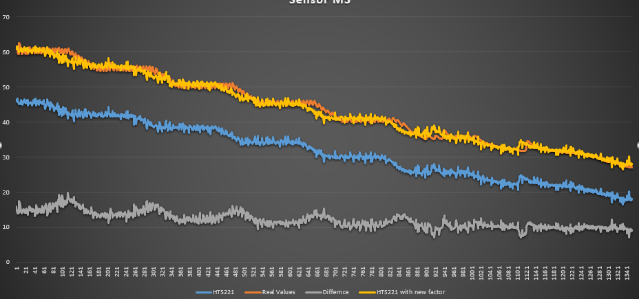

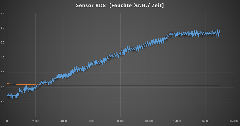

Hallo @Eleon BORLINI​ ,
we have just discovered that the sensors do not have the same difference so we can not solve this problem through a new offset.
in the attachment there are output from 2 sensors. the difference are obviously not the same .
is there anything we can do?
