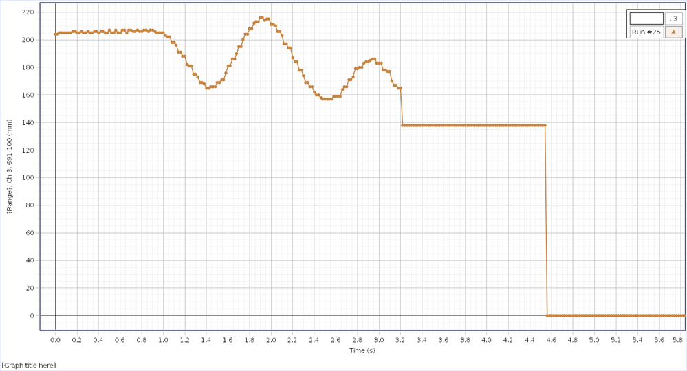

I am using the VL53L1CB and I am seeing it report valid range data when it shouldn’t.
I place a target in front of the VL53L1CB and it reports the distance to the target without any problems. However, when I remove the target and the VL53L1CB points off into an out-of-range distance, it will continue to report the same value for a while before it decides that it can no longer acquire the range (i.e. rangeData.RangeStatus is still reporting success after the target is removed).
This duration of this behavior seems to be dependent on what is behind the target.
Is there a way to always immediately report when the target has been removed?
Thank you
Scott Wild
This is the data I'm seeing. Note that I remove the target at 3.2 seconds.

The solution to this problem turned out to be checking the RangeQualityLevel as well.
                VL53L1_RangingMeasurementData_t rangeData;
                if( VL53L1_GetRangingMeasurementData( &vl53l1Dev, &rangeData ) == 0 )
                    // If the sensor chip returned a valid value
                    if( rangeData.RangeStatus == 0 && rangeData.RangeQualityLevel != 0 )
                        range = rangeData.RangeMilliMeter;
                    else
                        range = 0;
