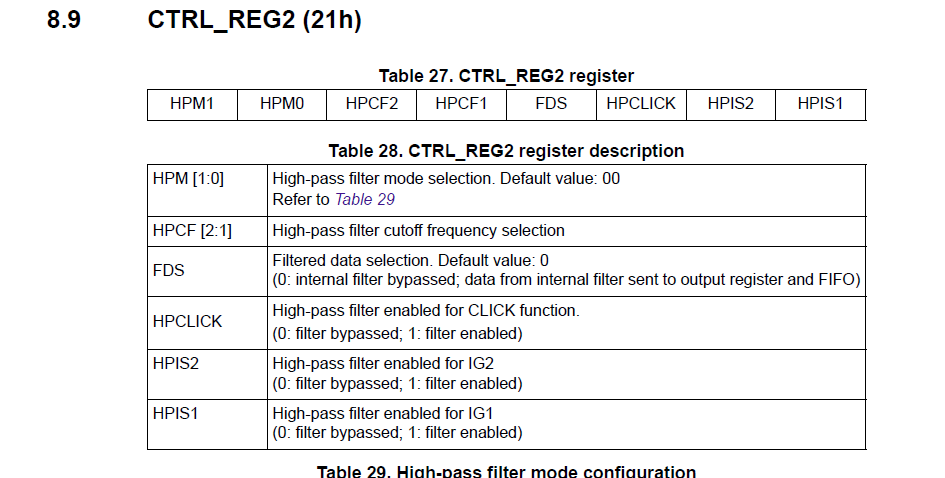

The purpose is to detect the car accident while ignore the normal acceleration variance during car driving.
I know there is a high pass filter in the lis3dx sensor, and the cut-off frequency can be changed by setting the following register (with actual cut-off frequency related to ODR setting) but don't know how to choose the best value. I guess there is experience value for the ODR and HPCF settings in car application. Anyone have relevant experience and would like to share it with me?

The real-time quality of the accident detection in my application is not that critical so no question about that. It's a product that help mark the video taken by the camera in case of car accident. Yes, a car rolling over a roof is definitely a car accident but it still can be detected by the lis3dx sensor even if the high pass filter is applied, can't it?
The reason I'm asking about the high pass filter setting is because the high pass filter can help attenuate the acceleration signals generated in normal car driving which is rather gentle in most cases. Also high pass filter can help remove the dc components.
I also find with the same threshold and duration setting, the lower HPCF setting can cause the interrupt trigger more easily in case of normal car driving. I deduce that the lower HPCF attenuate the signal generated in normal car driving less and cause the interrupt trigger easily.

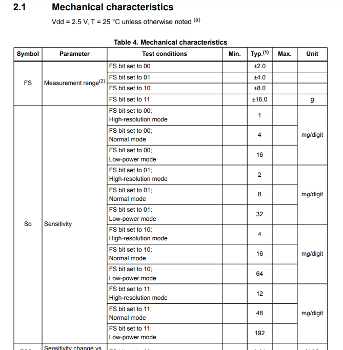

Also, this part of the
http://www.st.com/resource/en/datasheet/lis3dh.pdf
states resolution per LSB (''digit'') for each range:0690X0000060AU0QAM.png
David
Posted on April 09, 2018 at 10:01
Thank you very much for taking the time to reply. The conversion of the values is in accordance with the manual, and they are correct. When flat, the X and Y axes tend to be 0, and the Z axis is about 1g. Then I use the device to gently knock down the table when I do the impact test. Some axes can detect 10g or so. It's a bit unintelligible. 10g acceleration shouldn't be very big. I'll tap it so that it can produce such a large acceleration. It's a little puzzled, so I'd like to ask you about it. Have you tried this kind of crash test?
