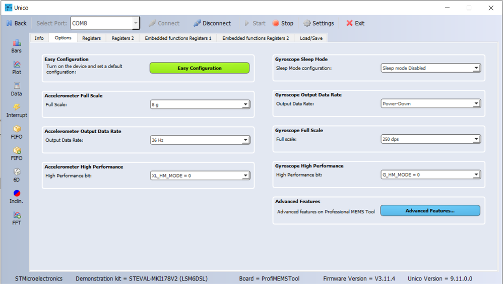

Hello ST,
I am using the Unico 9.11.0.0 version software (STEVAL-MKI109V3 board) with STEVAL-MKI178V2 ( LSM6DSL ) Sensor board.
from this link- https://github.com/STMicroelectronics/STMems_Machine_Learning_Core/tree/master/configuration_examples/example_5_profi_unico
I found " UCF files can also be converted to C source code and saved as header .h files to be conveniently included in C projects: click on the Options tab, select Browse and load the UCF file, then click on Generate C code."
In the Load/Save tab tried to load the .ucf file but didn't get the " C code generate option.
0693W00000JNAbYQAX.pngNext click on Option tab below window appear :
Could you please help me because i didn't get Generate C code option...

Hi Deepak Aagri @Deepak.Aagri​ ,
The "C code" generation option (from the .ucf file) is available from the LSM6DSR part number (STEVAL-MKI194V1).
0693W00000JNhF6QAL.pngUnfortunately, for older parts such as the LSM6DSL, the option is not available.

Yes i ordered STEVAL-MKI194V1 and its working..
Further How to use C generated .h file in your code : below link may help_
https://community.st.com/s/question/0D53W00000vPiveSAC/how-can-set-register-values-of-lsm6dsox-from-ucf-file-without-using-motherboard
