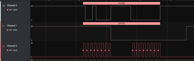

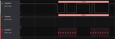

Here is the data sent as seen by my logic analyzer (Chip Select is not pictured in this screenshot but it is low for the entire 16bit transfer)
First 8 bits is the address 0x10 (+write bit which is 0) and the next 8 is the data I want to write to it but if I read back this exact register after a short delay the register still shows 0x00.
(this is the same address, the first bit indicates read or !write so it looks different)
Reading registers seems to work fine. (registers like the who am I register return the correct data)
Does anyone know what the issue could be
