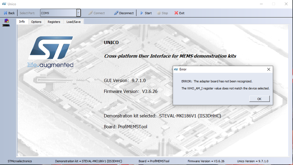

Trying to evaluate the MKI184V1 using the STEVAL-MKI09V3 and Unico v. 9.3.0.0 but just got an error dialog saying "ERROR: The adapter board has not been recognized..." The MKI09V3 is flashed with the latest firmware. Any ideas on what may be wrong?
Attaching a screenshot over how it looks.
Windows 10 version 1909
Kind regards,
Johan Dahlgren

Hi @GTheo.1​ , did you downloaded the last Unico version (v9.7) available online at this link? If not yet, please check now if it is working. Regards
0693W000000UeBxQAK.pngHi Eleon,
Yes - I have v9.7.1.0 Unico installed with board firmware version upgraded to v3.6.26 via the STM32CubeProgrammer software.
Windows 10 pro 64 bit OS

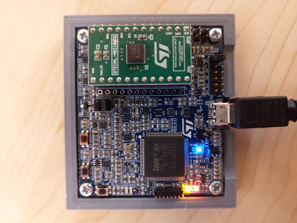

Hi @GTheo.1​ , the adapter looks correctly mounted and the ProfiMEMS jumpers are OK... Can you please try with another ProfiMEMS, if you have one in addition, or another adapter? In case of issues, can you try the connection on another PC? Regards
GTheo.1
Hi Eleon,
Tried on a Linux machine, same issue.
Purchased another MKI186V1 eval board, same issue.
Turns out nearly 1/2 the connections on the MKI109V3 PCB header were not soldered - pic below. Posted the solution here in case others have similar issues:
