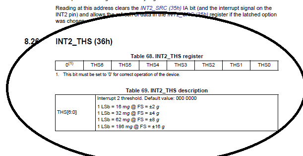

ST LIS2DE12 1LSb = 16mg @FS = +/- 2g ?
antonius
Senior
Dear ST Community Members,
I have question,
Related with
ST LIS2DE12 1LSb = 16mg @FS = +/- 2g ,
What does it mean in math calculation ?
Datasheet
https://www.st.com/resource/en/datasheet/lis2de12.pdf
page 43
Thanks

​Hi antonius, the 1LSB you are referring (16mg) is the minimum selectable threshold. The sign and the axis of the threshold is selectable into the INT1_CFG (30h) register

So 2g = 2 g-force, 2 * gravitation force ? mg = mili g-force ?
Thanks
Eleon BORLINI
​hi antonius, yes, the "g" surface earth acceleration (9.8m/s^2) is the typical unit of measure for an accelerometer, and mg stands for milli-g

so if the value = 0x01, it is 16mg @ +/- 2g FS, FS = full scale, correct me ?
You're right. Remember to select sign and axis in INT1_CFG reg.
