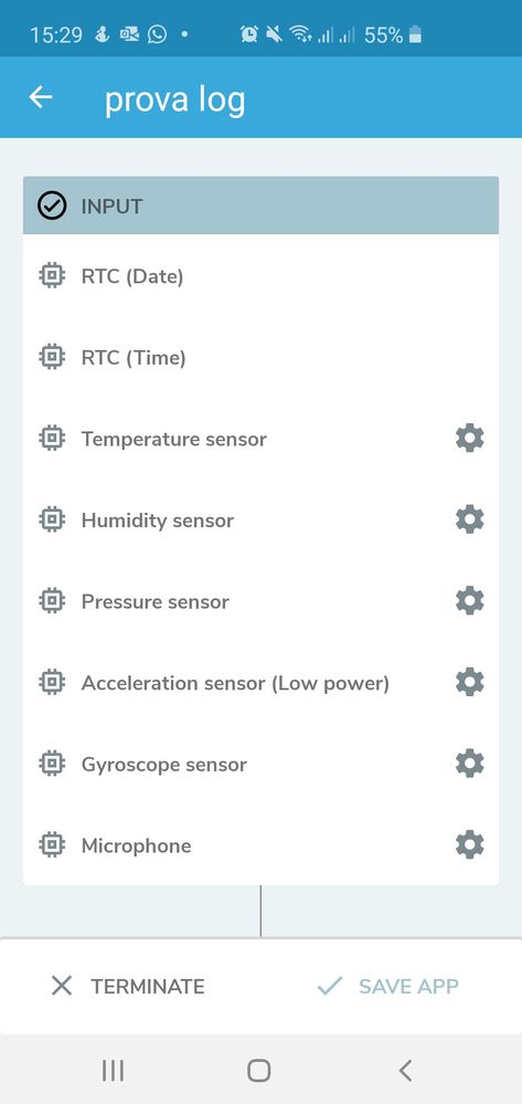

can you tell me which functions should i use so that the data capture will be same for the differnt sensors i am also using the sensors Input Sensors:
1.      Humidity (HTS221)
2.      Temp (STTS751)
3.      Pressure (LPS22HH)
4.      Vibrometer (LSM6DOX)
5.      Gyroscope (LSM6DOX)
6.      Microphone(MP23ABS1)
cuz in the output of csv file that is uploaded in attachment, i am getting the date and time different as when accelerometer starts logging at the same time gyro stop logging (see the A column A of "microphone and accelerometer and gyro) but i want to log the this column A (date) should log same time for all the sensors.
Hi @Pgarg.1​ , not sure if I catch your question... no "Function" is needed, because the sensors outputs data at different ODR but they are synchronized in the csv file, meaning that if acc outputs data at 50Hz and gyro at 52Hz, you will have the same acc data once every 50 samples more or less. Attached the overall data log.

"The app you designed(prova log), there you used two inputs more (RTC (date and time)) as showed in above screenshot "
Firstly, tell me are the RTC sensors you used for synchronization (if yes then why the date in your csv file "output.csv" is not changing after 24 hours) ??
Secondly, also i am using the same input sensors but my app is not uploading on the st.box (can be seen in the video attached) and,
  1. for the input sensors ODR would be kept at "default frequency" ( as i want the synchronized and integrated output for the sensors as you have showed in the file but also for microphone too)
  2. should i use the available functions (actually what role they are playing can ou tell me)
  3. and where should i stream the output (i guess you are using the sd card so i did the same).
Hi @Pgarg.1​ ,
>> but aslo in the output.csv the log of microphone is not reflected
This is right, the microphone has to be treated separately from the other sensors, by now. The app mixes the .csv data and the .wav data resulting in a wrong .csv file. Better to exclude the microphone by now.
The highest ODR drives the timestamp, e.g. the ODR 52Hz of gyro or acc. So, for the sensors with lower ODR, sometime you will see the same data reported.
Right, you get into an error, but if you then connect to your ST.box you will see that the app has been correctly downloaded on ST.box MCU. We have to solve this pop-up error after separating mic raw data (.wav) from other sensors (.csv)
Regards
