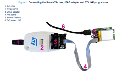

1. connect the sensortile to PC via USB and STLink as picture with battery unconnected

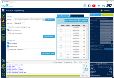

click the second icon, browse the BLEFOTA_BL_1.0.0.bin file in the FOTA folder (https://www.st.com/en/embedded-software/stsw-mksbox1-bl.html) and set all parameters as in the picture below:
4. start program
5. then, restart the sensortile (unplug and plug the sensortile USB) and you can see by the smartphone app the board ST.BOOT
6. connect to st.boot and you see the firmware upgrade request
7. start the firmware upgrade, when the upgrade is terminated, restart the sensortile and the smartphone app
4. start program

I successfully restored the board using the ST Link V2 as described. Just a tip for other users: the guide states that "Pin 1 is labeled on both parts and should be connected with the cable pin 1 (black wire)." If you are using the cable provided with SensorTile.Box, you have a bus with a red wire. Connection on ST Link JTAG Adapter cannot be done uncorrectly, but you will see the red wire is not connected to the PIN 1 on the adapter. For this reason, when connecting the bus on the SensorTile, just be sure that the PIN 1 on the JTAG Adapter is connected to the PIN 1 on the SensorTile, regardless on the color of the wire, otherwise it will not work.
