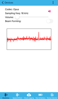

In this project, if I directly build and upload the .elf file the firmware is working very well. You can listen the recorded voice (voice name "PA10_Test_Record.wav") that was recorded by "ST BLE Sensor Classic" IOS app through P-NUCLEO-WB55.
As you can see the screenshot below: (The voice can be seen clearly)
Until here everything is OK.

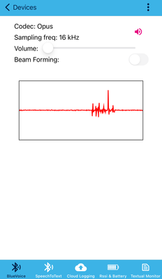

After, these changes, I recorded the voice and it was too noisy like recording a voice during driving an open car. Sensitivity was decreased. I have to be close to the microphone around 2-3 cm to record my voice. (Normally 30 cm was pretty enough to hear the voice) You can see the output result below: (Same sound, closer distance) In addition, you can find the voice record in the attachment as "PB15_Noisy_Test_Record.wav"

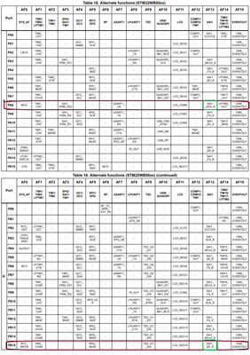

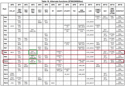

 I must change PA10 pin to PB15 pin. Because the only available pin was PB15 on my design. If you ask me why you changed AF number you can see the table from STM32WB55 datasheet:
Default project AF Pins:
After change AF Pins:
As a result, I should be able to run the project in the same way by using the PB15 pin instead of the PA10 pin on the default project pins PA8 clock and PA10 data pins.
