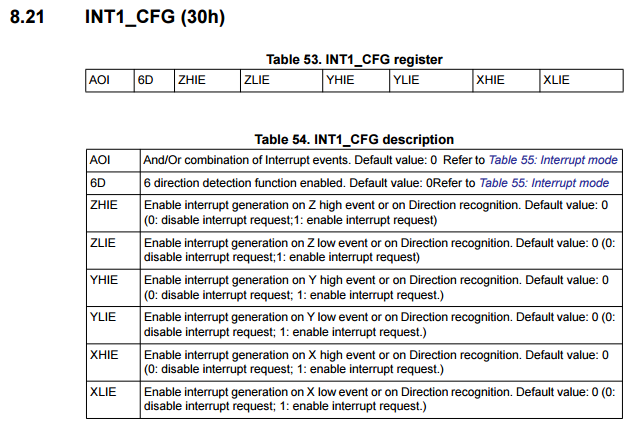

INT1_CFG = 0x7F //6D direction mode enabled, all directions enabled

First of all to enable all three axis the value of CTRL_REG1 must be 0x27.
Than you configuration of
INT1_CFG = 0x7F is not correct, basically you set the interrupt to be triggered if the acceleration is below or higher than threshold in any axis so this is always true.
So you should configure to enable interrupt only if the acceleration is higher than threshold, please be aware absolute value is evaluated, so it doesn't matter if the value is positive or negative.
You should also enable the high pass filter, because there will be always 1g of gravitation which would trigger the interrupt. The high pass filter will also omit any offset.
CTRL_REG1 = 0x27 //10Hz, normal power mode, ZXY enable
CTRL_REG2 = 0x01 // HP filter for INT1
CTRL_REG3 = 0x40 //IA1 enable
CTRL_REG4 = 0x10 //scale 4g
CTRL_REG5 = 0x08 //interrupt 1 pin latched
CTRL_REG6 = 0x02 // change interrupt polarity, active low as requested
INT1_THS = 0x02 //64mg threshold, 0x01 can be close to noise so the interrupt would be triggered by the noise
INT1_DURATION = 0x05 // 0.5s to activate interrupt
INT1_CFG = 0x2A //OR, X,Y,Z higher than threshold
