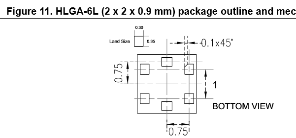

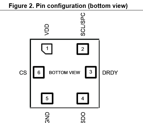

Is the pin out diagram on page 6 which is labeled ''bottom view'' actually a view from the top?

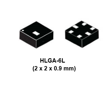

VCC is in the upper left corner (pin 1).  The top side view shows the pin 1 ''dot'' also in the top left corner.
and finally the mech drawing shows another bottom side view which contradicts the figure 2 drawing..
whats correct?
thanks

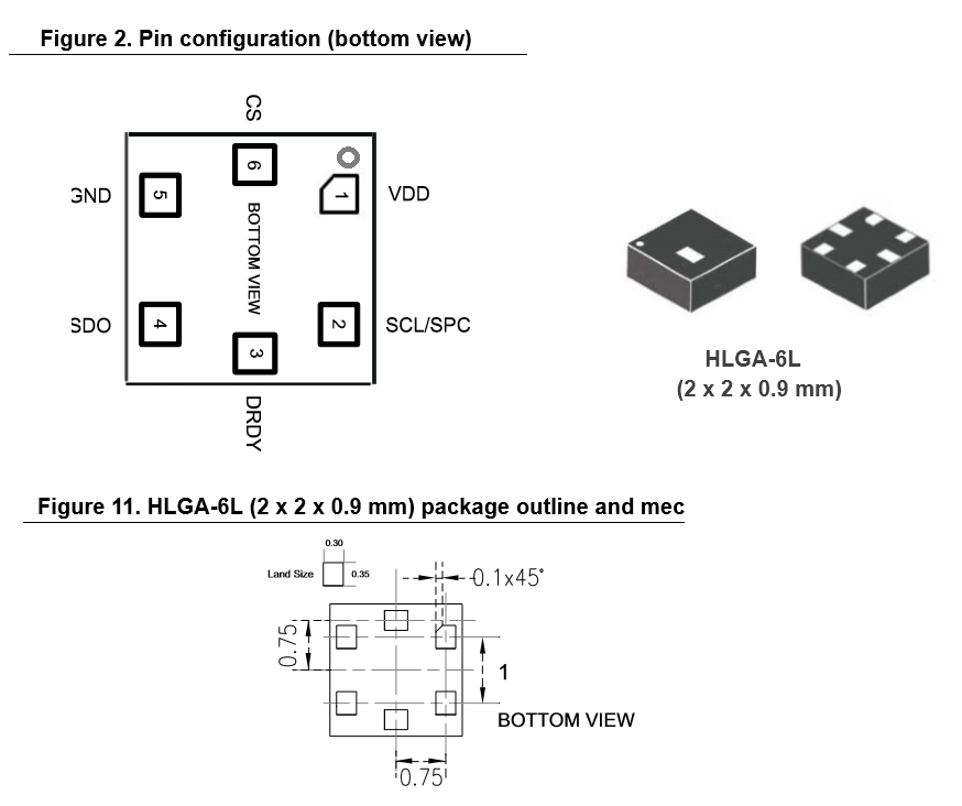

actually I see that the mech drawing is actually rotated so it matches the figure 2 drawing but the tops side pin 1 mark still seems incorrect.
Posted on January 29, 2018 at 10:24
All three picture are correct.
I have rotated the picture with pinout by 90 degrees so it should clear now.
Posted on January 29, 2018 at 14:37
Just to confirm this is the bottom view, for making a pcb model I would need to flip it along the vertical access so that the pin 1 is in the upper left corner?
Posted on January 29, 2018 at 14:41
vertical axis...access sheeee!
Posted on January 29, 2018 at 15:30
Yes, you are right.
