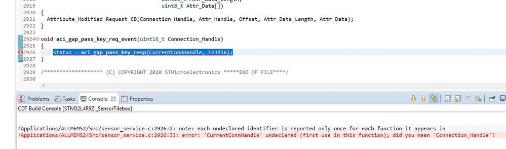

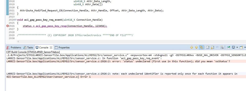

Hi Niccolo,
I encountered couple of error
and second when i try to change CurrentConnHandle to Connection_Handle
I suppose that i need to declare some variables. I precise that i use the same FW version like you ALLMEMS2 V210
Thanks for you help
Regards
Hi @david binkowski​ ,
status is a variable that is there for debugging purposes, you can either
  • get rid of it, so that the function becomes:
void aci_gap_pass_key_req_event(uint16_t Connection_Handle)
  aci_gap_pass_key_resp(Connection_Handle, 123456);
  • or declare status as a uint8_t the line before, so it becomes:
  uint8_t status;
  status = aci_gap_pass_key_resp(Connection_Handle, 123456);
in the latter option, you have a variable that can be checked during debug, but in the end it should not be a problem for you.
Let me now if this solves your problem.
