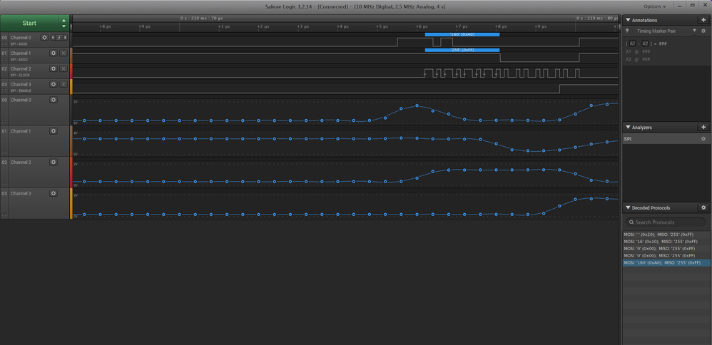

I am using nRF SDK 12.2.0 , with nRF52832 on pca10040 hardware, and working with the example in examples/peripheral/spi/main.c to develop a driver for LIS2DE12. When I write a hexadecimal value I find a problem. I checked with the scope that CS, MOSI and SCK are correct, but I get 0xFF on MISO line .
Any ideas what to check?

You didn't attach the screenshot from logic analyzer, but from you personal message I see that the communication is OK, I see that the LIS2DE12 responds correctly (0x33) to the who_am_i read request (0x8F). Firts 8 clock cycles the SPI master sends the request and next 8 clock cycles slave sends the respond. Please check the SPI communication diagrams in the datasheet.

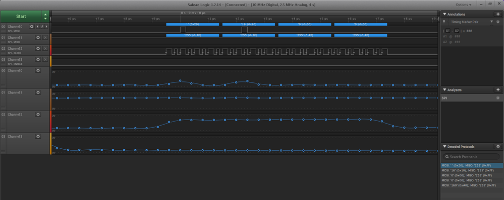

the problem is that I can read the default values of the registers, but when I try to write and read the register at the same time but I encounter a problem (a byte of ORC bits which is added during the write)
this a example CTRL_REG1
Write funcion
read function

The problems are caused by your SPI master (the microcontroller). I'm sorry I can't help you because I don't know
