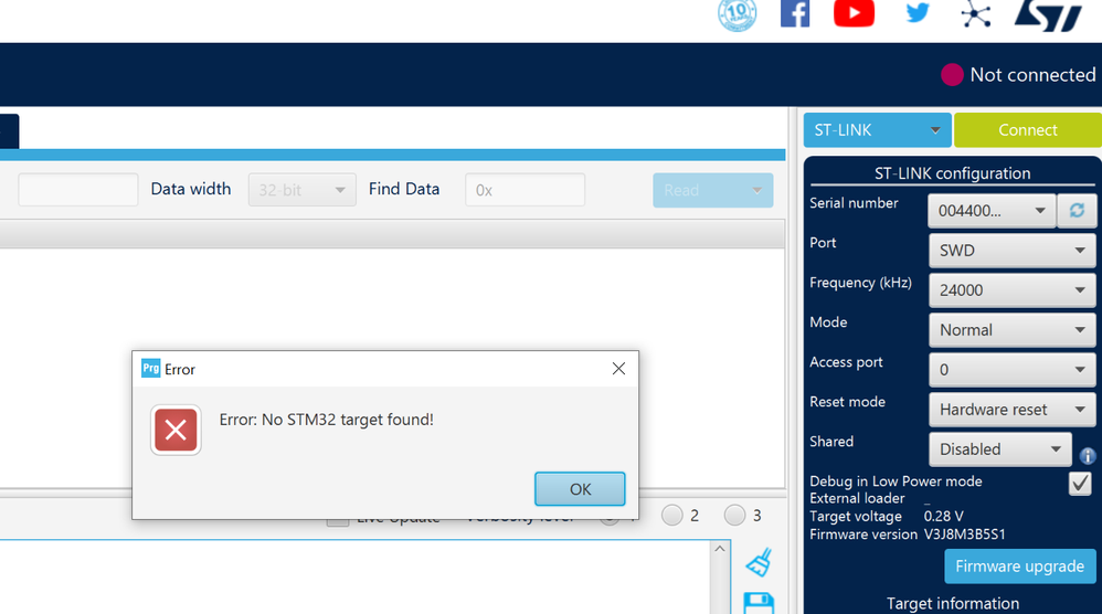

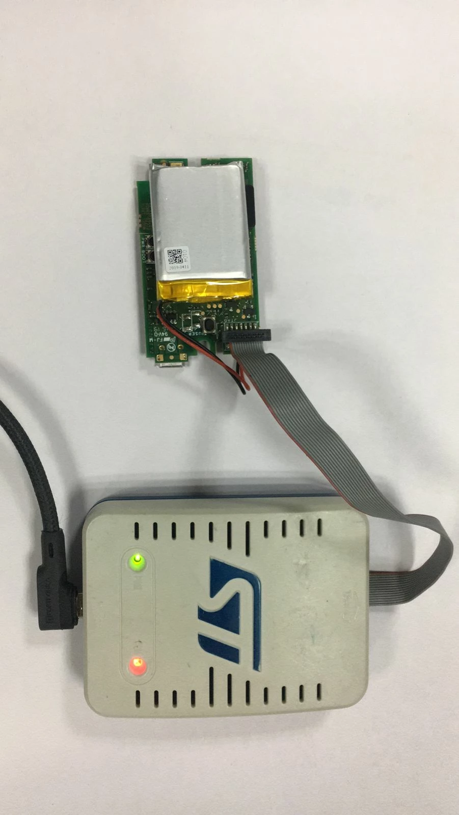

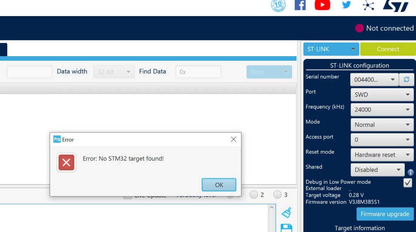

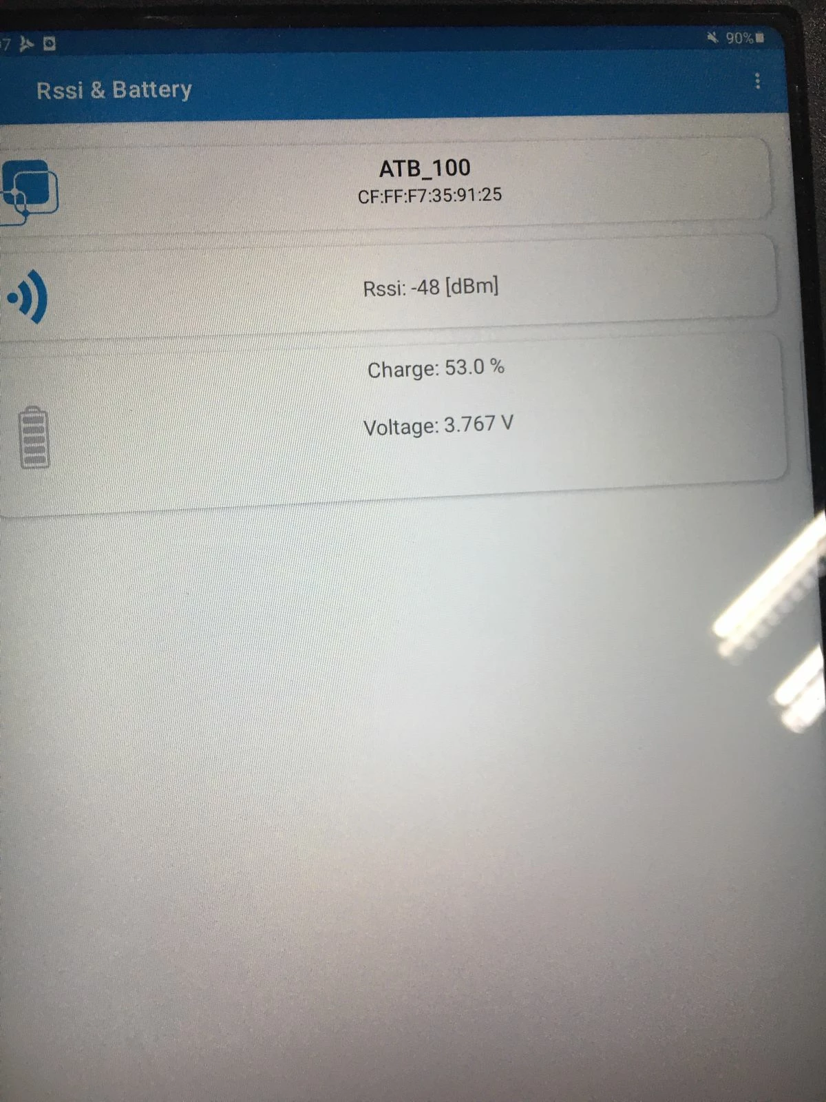

I have recently purchased Sensortile BOX , i can connect to it using st ble sensor application and it has a default cloud logging application.
I want to flash other applications like blemlc , etc ut not ale to connect to it
Attached are the pictures of the connection and issue.
Is it possible to flash other images over FOTA?
please assist!

    Hi @darla14​ ,
    Yes, it should be possible.
    Did you try to erase the MCU memory and try to flash the code in JTAG (programming) mode or DFU mode? Here an explanation about how to do it --> LINK
    -Eleon

    Hello @Eleon BORLINI​  ,
    Yes I tried erasing but the problem is "No STM32 Target found". I tried all the options of drop down ( USB, JTAG, DFU....)
    Could be some issue with my connections or faulty cable.
    I was just wondering cant I flash over the air?Any such binary or mode?

    I had a similiar issue with the Sensortile Devkit. Did you try holding the reset button while pressing connect while on the SWD connection? The reset mode should be hardware reset as shown in your image. May be this helps. :)
