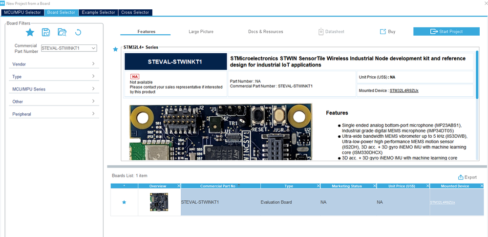

Depending on you target application (and on the data acquisition, for example USB or BLE streaming, WiFi, etc), you may start:
  • from the default application firmware, the FP-IND-PREDMNT1: you can find the source .cproject for the bluetooth communication in \Projects\STM32L4R9ZI-STWIN\Demonstrations\Predictive_Maintenance_BLE\STM32CubeIDE\STWIN_PREDMNT1;
  • from scratch by configuring the STWINKT1 board with the STM32CubeMX: here you can find the STEVAL-STWINKT1 board in the "Board selector", for the direct configuration based on the hardware constrains of the tool itself.

Hi @Shaun.t​ ,
the .ioc file is just the hardware default configuration of the STEVAL-STWINK1 pins, while the specific configurations of the applications/examples are set in the firmware.
The attached .ioc file is the one I generated selecting this board in the STM32CubeMX tool as described above.
-Eleon
