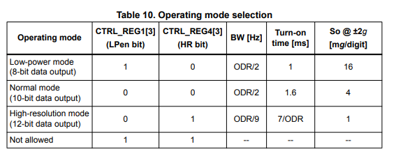

​Hi Max, so the CTRL_REG1 is well configured, as I understand. Did you check the integrity of the I2C communication e.g. checking the WHO_AM_I (0Fh) reg (value read has to be 33h)? Have you the possibility to check another device? Did you get the FFFFh value only during self test or also with normal mode running? Regards

Hi Max, for my understanding the flow was the following, right? You saw the sensor output never gave 1g on any axis (also the resultant on the 3 axis is never 1g), you tried the self test according to p.57 of the app note that went wrong and after that you re-check the sensor and it was broken, right? Or did it simply give the same results as before the self test)?
Just for checking, which ODR did you set in reg CTRL_REG1 (20h)? You have to format the data according to this table. Regards
I set the configuration registers as the procedure states. CTRL_REG1 is set to 47h, which sets an ODR of 50Hz. I also made sure to wait the stated time to allow for powering up and stabilization, in addition to discarding the first samples.
The tests I had previously done never gave reasonable results. Even when placing the accelerometer at rest and as flat as possible, I never got to measure anywhere close to 1g in any of the axes. As a matter of fact, when using it in the ±2g range, I always measured samples around the 25k mark (I mean the 16-bit integer from joining both the high and low bytes), which corresponds to more than 1g (~25/32 * 2g = 1,5g).
The self test by itself does not seem to have broken the accelerometer, as it continues to work the same way after doing it. I just don't know how to interpret the results, even though I do think there's definitely something wrong there. The results of the self test shouldn't be FFFFh, and even less on every axis, right? I don't have access to my program right now, but I will share the program with you, in case I were to be doing something wrong.
