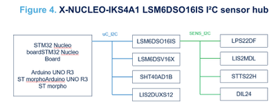

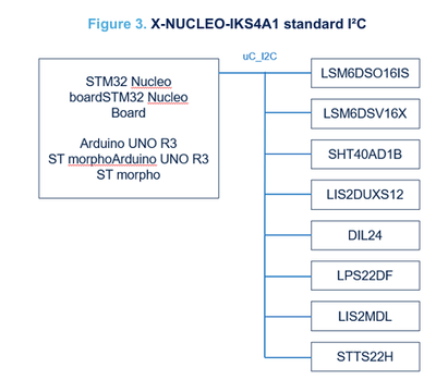

I am using NUCLEO_F401RE + X-NUCLEO-IKS4A1 with MEMS Studio software.
X-NUCLEO-IKS4A1 offers multiple various bus configurations, including the sensor hub mode for LSM6DSO16IS.

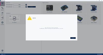

However, only in standard I2C mode can we establish the connection in MEMS Studio. If using the sensor hub mode, there will be WHO_AM_I warning and connection cannot be setup.
The issue doesn't appear in Unicleo-GUI since we can disable the sensor affected, but in MEMS Studio, the option cannot be changed.

Hi @Torris-Yin ,
Unfortunately, it is not possible to do this in MEMS Studio, which is why the sensor is not recognized.
