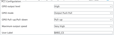

For the 2 Chip Select pins i have this config :
I don't understand where the problem comes from. Could someone help me asap ? I'm losing hope :(

Federica Bossi
Hi @yaxsomo ,
Using MKI109D motherboard with STEVAL-MKI251A, the sensor communicate correctly using your SPI configuration (Baud Rate: 4MBits/s, CPOL: High, CPHA: 2Edge) and assuming IMU_CS configuration same of BARO_CS that you posted.
Debug tips:
Are you sure that SPI2 lines are connected to LSM6DSV320X? Do they move on its side when communicate with the other sensor (oscilloscope probing)?
Did you check on IMU_CS behavior (oscilloscope probing)?
In your main FW when LSM6DSV320X communication takes place? Did you try to communicate only with it?

yaxsomo
Hello @Federica Bossi , I finally found the issue. It was a solder joint issue, and i blamed the software for nothing. One tip for other users that may encounter similar issues : When hand soldering a sensor like this one with a hot air gun, first apply solder on the PCB pads, then apply solder ALSO on the sensor. I applied solder on PCB pads but not on the sensor, resulting in really poor connection and therefore, a unusable IC.
