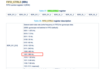

LSM6DSV16X FIFO batch data rate
fluchc

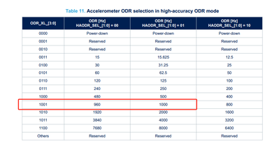

In high-accuracy ODR mode, can the frequency of writing to the fifo be automatically aligned,
for example 960 to 1000hz
Federica Bossi
Hi @fluchc ,
The FIFO rate is always aligned to the ODR or its submultiples. If you put 1000 Hz and BATCH_RATE = 960 Hz then BATCH_RATE will also be 1000 Hz. If for example ODR = 1000 Hz and BATCH_RATE is 480 Hz then the real batch_rate is 500 Hz.
