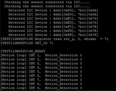

I am using an STM32H562VI board with an LSM6DSV16X sensor,
and when I read the whoami value, it reads as 71.
I configured the register as follows to check the interrupt on INT1.

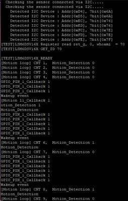

The LSM6DSV16X does not generate interrupts.
The same code above works fine with interrupts on the LSM6DSV32X sensor when only the ID (0x70) is set.
Is there a difference in the configuration or register settings between the LSM6DSV16X and LSM6DSV32X?
Which part should I check more?

Federica Bossi
Hi @heesu ,
The power on sequence for both the devices is the same and they both have whomai value 70.
Can you try to implement our official PID and let me know if you read LSM6DSV16X whoami correctly?
Thanks!

Hi,  @Federica Bossi
It was implemented using the official PID.
However, the whoami value for the LSM6DSV16X is 71.

Is there any LSM6DSV16X product with a whoami value of 71?
Thanks!
