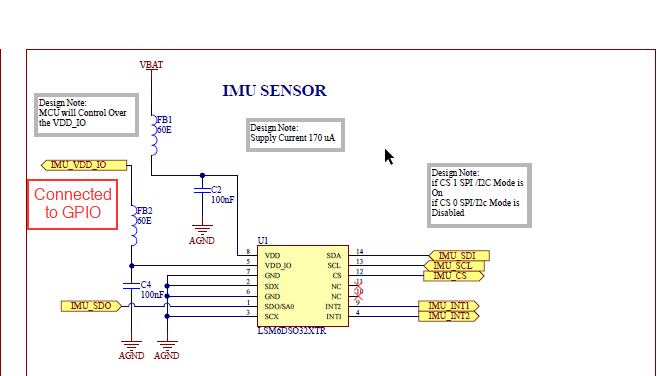

0693W00000SttviQAB.pngI have powered from LSM6DSO32 through a 3V Coin cell battery and connected with Nrf52810 using I2C.
Without any coding sensor taking around 2mA and after flashing its taking 4MA.
I am getting the readings correctly.
Attached the schematics

Hi @V.Jose​ ,
the baseline consumption looks high too... did you placed pull-up resistors on I2C lines?
Note that, as reported in the datasheet, both I2C lines (SDA and SCL) the lines must be connected to Vdd_IO through external pull-up resistors. When the bus is free, both the lines are high, so if you tie them to GND by default in your application processor, you might experience high current consumption.
-Eleon

Hi, Eleon,
Thanks for your response. we are using internal pullup
Hi @V.Jose​ ,
are the pullups always active, even when you do not communicate I2C?
