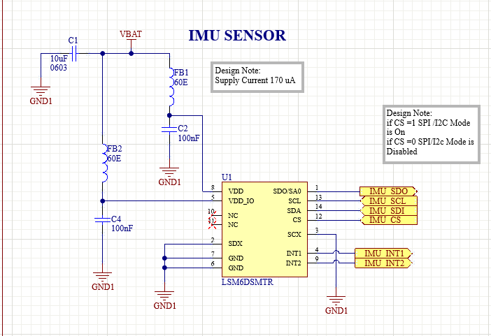

LSM6DSMTR Taking more power on VDDIO Pin
V.Jose
I am using LSM6DSMTR  with a coin cell battery. I have connected the IMU with NRF52810 using a SPI line. Attached the screenshot.

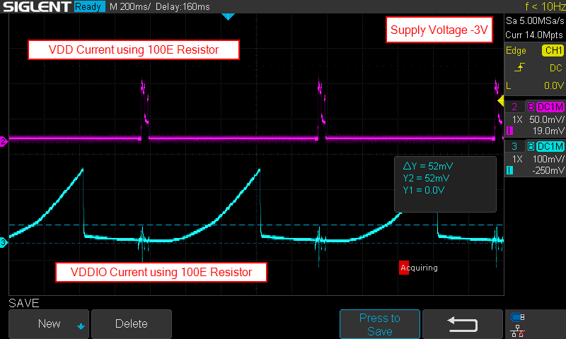

When I am observing the power profiler, VDDIO is gradually taking current after the SPI communication (I have used a 100E resistor( to measure the current).
If I disconnect the VDDIO, the unit is working, but its taking power from SPI lines , and the total power consumption of NRF52810 increasing

I am using the SPI channel, so SDO is connect to MCU pin only
