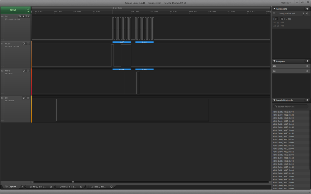

Hi all, I'm trying to bring up an LSM6DSM (MKI189 dev board) via SPI using a Nucleo and the STM C libraries for it. I've had some luck but I'm getting extremely unreliable SPI communication ( MISO line specifically ). For starters when I read the WhoAmI register I sometimes read 0x6A as expected but I read a number of other things as well ( 0x60, 0x40, 0x44 ) are common.
I've been trying to use the logic analyzer to figure out what's going on and I've noticed that depending on how the board feels having the Logic Analyzer (Saleae) attached can make things better or worse. I have my code reading the register every 100ms and I'll try disconnecting/reconnecting the harness from the logic analyzer. Sometimes plugging it in make it impossible to read the correct value and sometimes unplugging it makes it impossible. During the transition of plugging in/unplugging it almost always is able to read the correct value. I suspected noisy lines at first but I'm running at 20kHz now.
Does anyone have any suggestions on where to look to debug this?

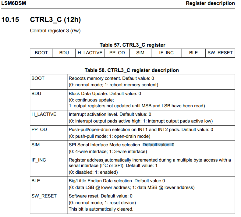

‎2019-04-19 10:11 AM
Older MEMs boot up in 3 wire, the MISO line not being activated, hence you can't really read anything steady.
Writing blindly some control register bit to activate 4 wire mode was needed.
In 3 wire mode, you need to short MISO and MOSI of STM32 AND disable MOSI when reading (GPIO.MODER register to flip)
‎2019-04-20 6:20 AM
Looks like this MEMs defaults to 4-wire but I tried 3 wire and writing that register regardless. Still the same behviour. Any other thoughts?
‎2019-04-20 6:40 AM
I just noticed something new. If I remove the MISO connection between the STM32 and the LSM then I see the LSM outputting the correct 0x6A response very consistently. It's almost like the STM32 is not allowing the LSM to drive the line the way it needs to.
‎2019-04-20 10:44 AM
ok, then in debug mode, put a breakpoint and look at the GPIO and SPI HW registers.
You can even manually change them and let the code continue...
Check HW registers bit by bit against the reference manual register description and find the flaw.
