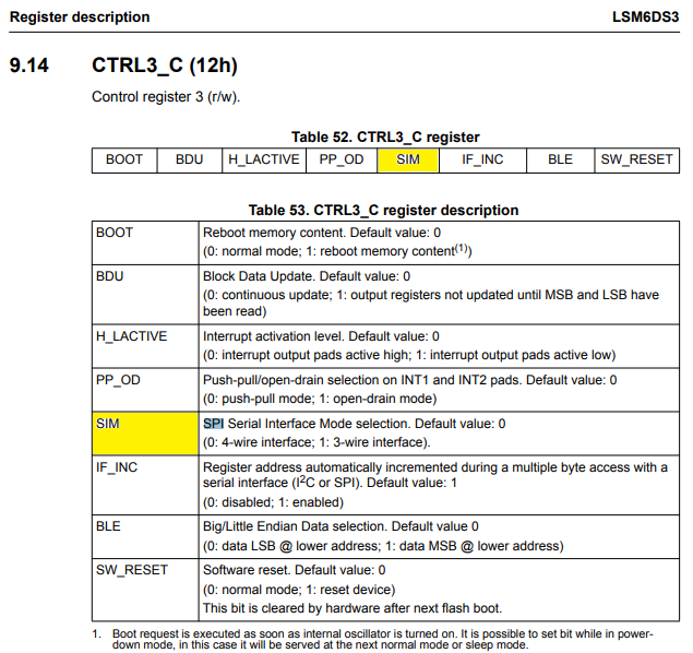

I tried to work with mbed LPC1768 and LSM6DS3-Dev-Board from Sparkfun.
The connections:
uC - LSM6DS3
VOUT 3V3 regulated Out - 3V3
GND-GND
SCLK-SCL
MOSI-SDA (SPI SDI)
MISO-SA0
CS-CS
The Code:
#include "mbed.h"
Serial pc(USBTX,USBRX);
SPI spi(p11, p12, p13); // mosi, miso, sclk
DigitalOut cs(p14);
int main() {
    pc.baud(115200);
    pc.printf("Start");
    spi.format(8,3);
    spi.frequency(100000);
    // Select the device by seting chip select low
    cs = 1;
    wait(1);
    //Set Register to Default Mode
    //Set SPI to 4 Wire-Mode
    cs = 0;
    spi.write(0x12);
    spi.write(0x04);
    cs = 1;
    wait_ms(1);
    uint8_t result;
    while(1){
        //Select chip
        cs = 0;
        //address
        spi.write(0x8F);
        // send a dummyvalue of 0 to read the first byte returned:
        result = spi.write(0x00);
        //deselect chip
        cs = 1;
        // Send 0x8f, the command to read the WHOAMI register
        printf("WHOAMI register = 0x%X  \n ", result);
         wait_ms(1);
It returned 0x7F every time.

ogris
Well, my English is not the best.
How i thinks it works:
In Setup i write ( 0x00<write>||0x12<registeraddr>) to say i want to write to this CTRL3 register.
And then I write 0x04 to set the bits. -> 0x04 means SPI on 4-Wire mode.
Then I write (0x80<Read>||0x0F) for Who_is_me.
At the end i send dummybites to shift the answer to my uC and print it out.
S.Ma
Principal
Yep, this sensor default after power on to 4 wire mode.
If you want 3 wires, you must write SIM bit first, then do the reading.
ogris
I want 4 wires and the settings are on 4 wires but i still get no data.
If you look on the osziloskop-Pictures you will see that something is wrong.
