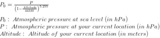

the value that the sensor gives me after the conversion of absolute pressure in the sea level it's wrong.
The absolute pressure i read from the sensor is 973.7 hpa and the temperature is 22.3, i used the mathematical formula:
to calculate the pressure in the sea level. My location has 45 meters altitude and i measure absolute pressure 973.7 hpa with this data the computational pressure on the sea level is 980.5 hpa.
I compared the result with the nearest weather station in my area and it was a mistake, the weather station wrote 1020 hpa.
Why it exists such a diviation;
