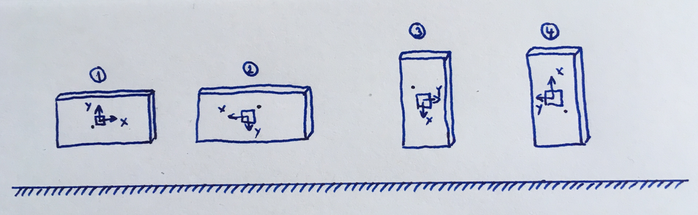

The INT1_THS register value change the threshold. I think there is misunderstanding with the sensitive axis as you enable only X and Y.

The threshold apply to all axis.
If you enable only X and Y axis following positions will be detected.

OK, unfortunately I'm not able to replicate your issue. To me the threshold change the angle where the positions are detected.
I will check with my colleagues, what could be the issue and come back to you.
