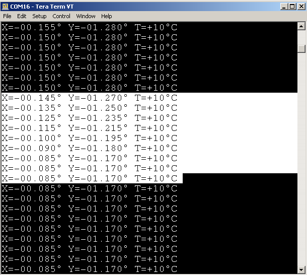

OK, if I put aside the jump.
You changed the temperature from 45°C to 5°C and the tilt angle in X axis changed -90 to -40 degrees. This is impossible, obviously you have something wrong. See below the specification of the LIS3DHH.
alessio31183
Sorry Miroslav I was speaking about that sudden jump around the 5°C.
I was not speaking about the temperature movement. That's normal, I know and it's what I compensate in firmware during the temperature test in the climatic chamber.
Of course each accelerometer has a different temperature behavior and it's compensate one by one.
It is not normal to have 50 angle degrees change (from -90 to -40) change if you change the temperature from 45°C to 5°C!
alessio31183
No sorry the data that you see is the raw accelerometer data without the tilt computation.
It was only to check if the jump coming from my tilt computation in firmware.
Attached you see the same picture but with the tilt value
alessio31183
Miroslav, sorry, have you got the point?
Miroslav BATEK
Yes, I got your point. Let me discuss with sensor specialists.
alessio31183
Hi Miroslav, do you have some news?
In the meantime I give yout another example on how data changes dramatically and suddenly without any motivation
Moreover, this behavior happens going down only with the temperature and NOT going up
Thanks in advance
alessio31183
Miroslav I've found the problem.
THE RESIN PROCESS ON THE ACCELEROMETER MAKES THIS STRANGE BEHAVIOR.
UNBELIEVABLE
Usually I did the process for all other accelerometer that I used in the past
Probably this time the resin was to hard and with a different thermal coefficient so it stressed the accelerometer position makes this sort of offset.
I don't want what to say. Sorry to everyone for the time that I made you lose.
Now I will do some other tests in order to be sure that this is the right solution for my application.
