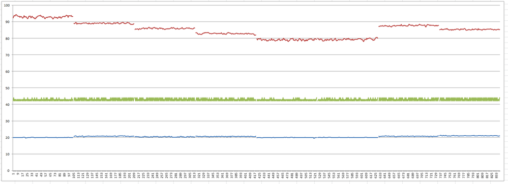

Hello! I am R&D inclinometer based on LIS3DHH. Firstly I started my works with LIS2HH12 as MEMS accelerometer due to his best accuracy and resolution. I wanted to get accuracy about 1-2 angular minutes. All was good when I turned on almost all internal filters and using software moving average. Even with 7 sec response it was ok for my solution. But after few experiments I discovered problem with temperature stability. I decided use internal temperature sensor to compensate temperature coefficient and started temperature experiment (first with termal camera, but after without, because was a lot noise from camera). And I can't find out temperature coefficient for that. Next figure shows angle for one axis (red), temperature from internal sensor (blue) and reference signal from another special inclinometer. So, angle changed unpredictably on different days.

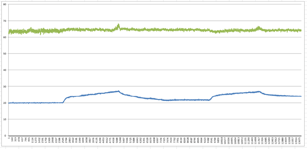

Next figure shows one angle (green) and temperature (blue). Here some unpredictable overshoot.

I have a few questions:
- How do you calculate the tilt angle?
- How did you measure the temperature?
- Is the first chart from LIS2HH12 and second from LIS3DHH?
- Form the first chart, it seems the angle change about more than 10 degrees with very small temperature change. Can you confirm that my understanding is correct?
- For the second chart the angle changed about 5 degrees but in the test you say 5 angular minutes.

- I calculate angle as standart. The same formula was in AN4509.
- I mesured temperature by internal sensor in LIS.
- Yes, you are right.
- No, 10 angular minutes. All angles on chart in angular minutes
