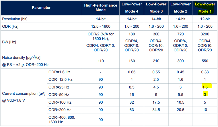

Hi @Dillah​ , supposing Vdd=vddIO=3V , HPM ODR 400Hz and Low Noise Enabled, the current consumption can reach 300uA. To better this current consumption and still be able to well detect single and double tap recognition, you could try to work in HPM, ODR = 200 Hz, Low Noise Enabled, and should be able to go below 180uA. Which is your power budget?
Note that the current consumption is strictly related to the ODR almost linearly. Regards

After some evaluation, we will try to use 25Hz or 50Hz ODR as shown on below image.0690X00000BwmISQAZ.pngI would ask if you have similar data of current consumption in 3V power supply for highlighted mode?
Thanks
@Dillah​, of course going in LPM will help the power budget requirements. The curr cons for 3V in LP1 at that ODRs is about 2.5uA with ODR 25Hz, so this is the condition in your case. Please note that the resolution lowers from 14-bit to 12-bit, you should have to check if you can detect the single/double tap in a good way. Regards
