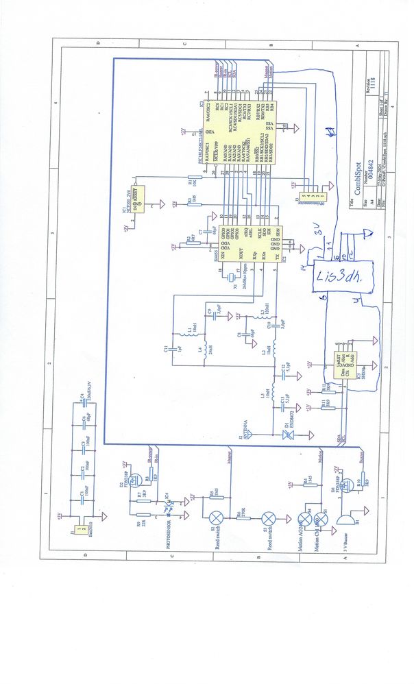

I use a LIS3DH connected with a Pic mainboard. I cummunicate with I2C and have set it up with interupt. I use 8mg, Lowpower and 50 hz odr.
I have a problems with Power Consumption. Before i insert the LIS3DH it use 3 microampere. After i have set it up with interupt i use 100 microampere. We use a STEVAL-MKI105V1 eval board.
How can i set it up so it only use 10 micro ampere.

Hi @BToft ,
That's sound strange LIS3DH in LP mode and ODR 50Hz should have a power consumption of 6uA. Can you share your schematic?
2024-07-05 2:33 AM
I have here a diagram. It is a testmodule.
2024-07-05 2:33 AM
