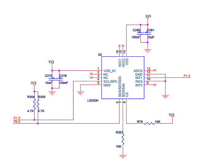

Hello Miroslav,
I also have a similar problem.The power consumption of 3.3v is160uA,and register 0 has been configured 0x
Then following is schematic diagram
‎2018-03-22 6:48 AM
LIS3DSH has internal pull-up on SEL/SDO pin.
It is possible to disconnect this internal pull-up by setting to 1 the bit 7 (MSB) of register at address 3Fh (do not modify the content of the other bits!). Note: this functionality is not guaranteed (and tested) by STMicroelectronics on LIS3DSH device.- Mark as New
