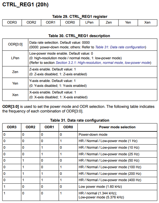

Or course you have to configure the sensor first, there are several modes and features which needs to be configured.
Please read carefully the datasheet and the application note.
You have to at lease set the Output Data Rate in CTRL_REG1.

I tried to configure
CTRL_REG1
then read OUT_X_/OUT_Y_/OUT_Z_, for example,
OUT_Y
_L, but I got different/changing value even though I didn't move it. It is normal?
Could you be kindly to review my log if anything wrong?
Thanks a lot.

It is absolutly normal, there is always some small noise, caused by the sensor itself or by vibration of the enviroment.

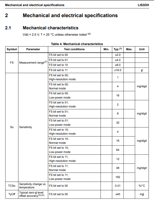

I would help if you convert the data into g unit, you would see the change is small and is caused by noise.
It depends which mode you are using, according to the mode the output is 8, 10, 12 bit left adjusted in 16 bit output register.

BTW, how to
convert the raw XYZ data into g unit?
Any reference?

Here is a section from the datasheet:
If you select a range, this gives you sensitivity.
The output registers store a signed number in a second complement format.
