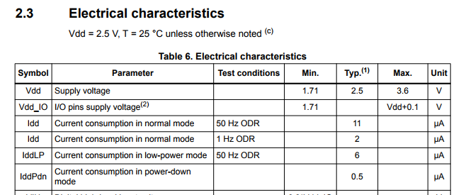

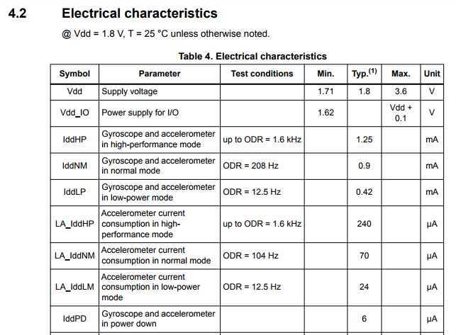

Regarding the power consumption:
Here is an extract from
http://www.st.com/content/ccc/resource/technical/document/datasheet/3c/ae/50/85/d6/b1/46/fe/CD00274221.pdf/files/CD00274221.pdf/jcr:content/translations/en.CD00274221.pdf
And similar for the
http://www.st.com/content/ccc/resource/technical/document/datasheet/a3/f5/4f/ae/8e/44/41/d7/DM00133076.pdf/files/DM00133076.pdf/jcr:content/translations/en.DM00133076.pdf
It seems that the gyroscope adds significant amount of power consumption compared to just an accelerometer. Also, as low Vdd as possible is needed.

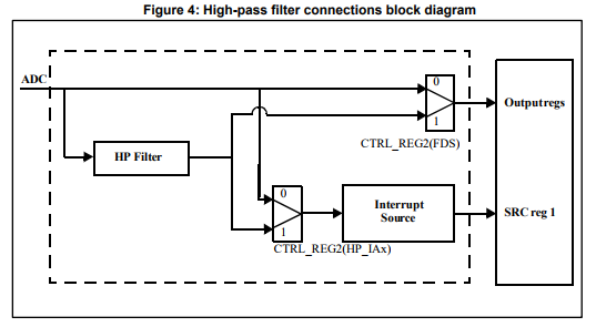

Oh, now I understand. The gravity is triggering your interrupt, because 1 g is above your 100 mg threshold.
I think you need to enable a high pass filter in your device, please see
http://www.st.com/content/ccc/resource/technical/document/application_note/77/ed/e7/e1/28/5a/45/d6/CD00290365.pdf/files/CD00290365.pdf/jcr:content/translations/en.CD00290365.pdf
, section 4.3 High-pass filter. This will remove the DC value from the readings.
David
Id At
Posted on February 06, 2018 at 15:03
oh thanks! I will try it.. just i didn't understand when i enable high pass with reference for example..which axis it takes place? we have 3 axis and only 1 reference..
Posted on February 06, 2018 at 21:02
The high pass filer is the right way how to make it working as you expect.
You can enable high pass filter, using normal mode HPM1 = 1, HPM0 = 0, it will remove the DC component from the signal, witnout need to set the reference.
Otherwise the reference is valid for all three axis.

Posted on February 06, 2018 at 21:18
I haven't tried that mode myself, but according to the diagram, it seems that the filter works for the ADC which is a source for all the output registers.
D.
