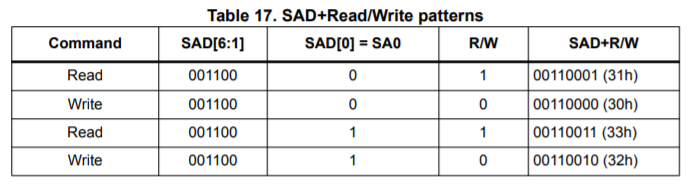

Hi @WSpar.1​ ,
I'm wondering if the de-codification is correct... I mean, is the I2C address the right one?
The blue pattern looks like it is on a different scale than the yellow one...
Do you have two different SA0 pin configuration? (now the value is 18h, before was 19h)
0693W00000AM0F1QAL.png-Eleon
WSpar.1
Yes, so I have the onboard IIS2DLPC on SA0 = 3.3v (0x19 + R/W) and the Accel 13 click board on SA0 = GND (0x18 + R/W)
But both devices act the same.
Maybe I'm having an issue in I2C read implementation?
I can write, otherwise I would not be able to configure the chip.
