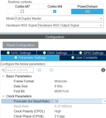

I am using STM32H745 to setup and communicate with LIS2DW12 accelerometer via SPI 4-wires. I am trying to setup the accelerometer and I started with reading the WHO_AM_I register. It's default value is (43h) and I changed the value of the first bit to '1' so that my STM32 can read the value.
The SPI communication is setup as follows:
With the read and write fucntions set like this:

When I observe the MISO and MOSI with a logic analyzer, I can see that good register value is sent, but I have random 0s and 1s as a return of MISO. Here is a picture of how it looks:
I tried to add a reboot and/or soft reset before reading the WHO_AM_I registor, but it did not change much. Does anyone know what is the cause of this behaviour and how can it be fixed?

Hi @NuEta ,
As written also in datasheet the whoami is 44h:
Moreover, I suggest you to follow our PID example to implement the readings of LIS2DW12. Let me know if this helps.
