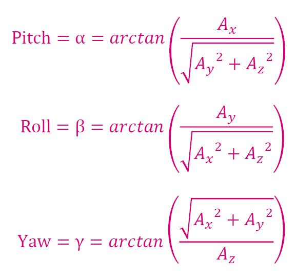

These formulas works for range -90° to +90° in all three angles:
For Pitch you can use other formula for range -180° to + 180°:
Pitch = arctan2 (Y/Z)
danybr
Hi Miroslav, thank you very much.. It seems to be working properly!
In order to make that I used:
pitch = (((Math.atan2(accelerationY,accelerationZ) * 180) / 3.14 ) + 180 );
By using the AccelerationY and accelerationZ provided by the device, than converted in degree and "+180" offset to get values from 0 to 360.
