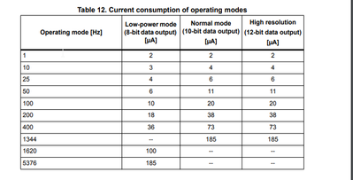

Are there any options to reduce the power consumption based upon the configuration I have set so far ?
This while still being able to sample at 10Hz 10 bit and using FIFO so that the MCU could stay 'disabled' most of the time.
For my project I need the accelerometer to sample @10 bit, 10Hz and 2G  with the lowest power consumption possible. I have used the FIFO to allow the mcu to sleep (for almost 3 seconds) when nothing else needs to be processed. When the watermark of 30 samples is reached I request it to (burst) read\request the values from the FIFO over the SPI interface (8MHz). The request I did get is to have a similar power consumption.
The drawn current of the entire setup is about 9.5 uA on average when using the lis2dh12.
But when using another accelerometer (bma253) I get about 7 μA total.
During the measuring I have seen that the minimal drawn power consumption is increased by 2.5μA.
Therefore I determined with the information available that the accelerometer itself is drawing the extra μA.
The following register settings are set at this time at startup:

Hi @Emiel ,
Welcome to ST Community!
The LIS2DH12, in LP ODR 10Hz and FS 2G, should have a current consumption of about 3uA, accordingly to datasheet:
You could try in asynchronous reading instead of using the interrupts, let me know if this reduces the consumptions.

At 8 bit it is 3uA, but we need to get 10bit values. Therefore it will be 4 according to the datasheet.
@Federica Bossi  are the configuration values correctly set ?
Did we not overlook some application note or a settings to reduce the power consumption?
We are also applying a voltage of 3.65V. The datasheet does not mention at what voltage we should measure 4uA.
I noticed that the current reduced  ~1uA  when applying 2.5V (when mcu sleeps and the lis2dh12 is sampling).

Hi @Emiel ,
The values on the datasheet are at Vdd=1.8V, we expect that as Vdd increases, current consumption will increase.
Your configuration is fine to have a low power consumption, as shown in the table.

Do you know what values we could expect at ~3.65V for the lis2dh12.
For another project I have the same question for the LIS2DU12 that mentions a current consumption of 3.4uA at 1.8V  @12,5 Hz. I would therefore also like to know what the expected current is at ~3.65V. Is that information available ?

Hi @Emiel ,
For LIS2DH12, a current consumption of about 5uA is expected in LP mode, Vdd=3.6 and ODR 10Hz.
For LIS2DU12, when ODR=12.5Hz, LP Mode and FS=2g and Vdd=3.6V we expect about the same values of LIS2DH12.
