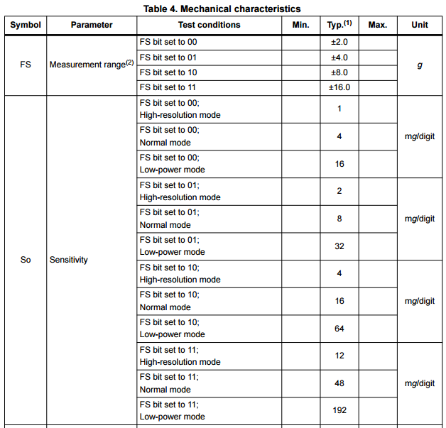

LIS2DH12 Measure conversion
Posted on June 06, 2017 at 09:20
I am having some problems when I try to get data from my sensor. I can read registers and get some data but I don't know how I should do the covnersion to get a real value.
I am using an arduino and I found some libraries. Those libraries tend to use this format:
x = ((int8_t)sensorData[1])*256+sensorData[0];
y = ((int8_t)sensorData[3])*256+sensorData[2];
z = ((int8_t)sensorData[5])*256+sensorData[4];
Where position 0 of sensorData starts at OUT_X_L (28h) and goes up.
Is this right? I have read something about left justified of LSB and I think it should be like:
Is it the same?
Apart from that, they use a formula to get mg values from the x,y and z values:
x = (int32_t)x*1000/(1024*mgScaleVel); //transform data to millig, for 2g scale axis*1000/(1024*16),
y = (int32_t)y*1000/(1024*mgScaleVel); //for 4g scale axis*1000/(1024*8),
z = (int32_t)z*1000/(1024*mgScaleVel); //for 8g scale axis*1000/(1024*4)
What is this about? where does this formula appear? Is it correct? How should I parse the data?

There is many ways how to do it, but lets use typical approach.
1. You need to first make one number from
High and Low bytes which you read from the sensor:
x_raw = ((int16_t)OUT_X_H<<8) + OUT_X_L;
2. Then you need to adjust the number according to the mode which you use (the data are left justified in the output registers):
- High-resolution mode (12-bit data output) x_raw = x_raw>>4;
- Normal mode (10-bit data output)
 x_raw = x_raw>>6;
- Low-power mode (8-bit data output) x_raw = x_raw>>8; (For this mode you can skip first and second step and use only the OUT_X_H)
3. Convert the raw data into g unit value using sensitivity for selected mode and full scale. The sensitivy value can be found in Table 4 in datasheet.
x = x_raw * sensitivity ... value will be in mg (milli g)
