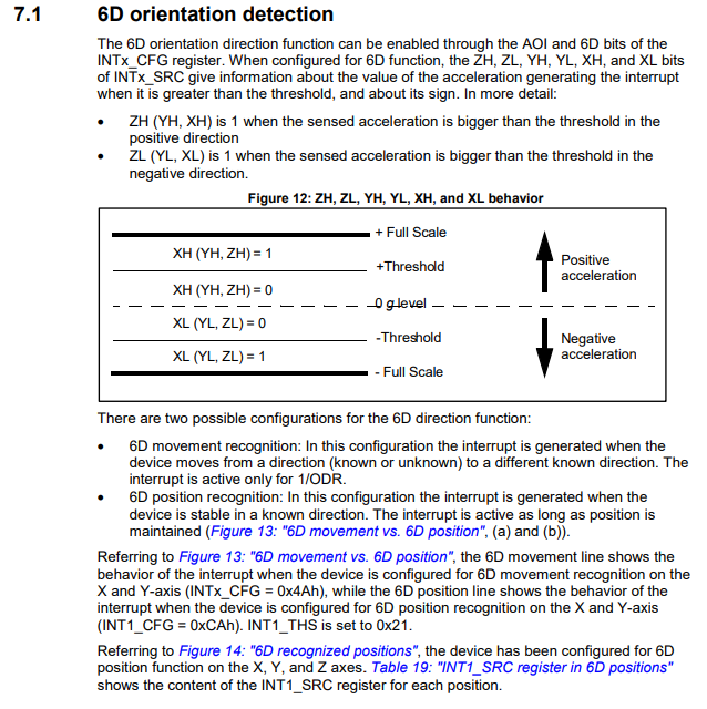

I am trying to implement 6D mode. I am following 1:1 the code documented in the design tip DT0097.
I have been trying for a while: I2C interface is working and other modes of LIS2DH work properly.
As a safety measure, during the init I reset all registers back to their default value.
I read IRQ_SRC as soon as the INT1 line is raised.
However, the behavior is not as expected:
I do get interrupts when I move the board, but:
  • If I move the board, I usually have 2 consecutive very near interrupts. The second is always with all the flags "low" set.
  • The value in the flags is wrong: even with horizontal position I never get neutral X an Y, or even Z if I put the board in vertical
  • The threshold, duration and registers seems to have no effect whatsoever
  • If I rotate very slowly the board, I can succeed to flip it without triggering any interrupt
In the interrupt, I simply read INT1_SRC, that should be enough, right?
This is an example of events I get while flipping the Z axis of the board. Val is the (hex) value of INT1_SRC, while the rest is the string is my decoding of it.
Do you have any hint or fully-fledged example?

Hi @vcaia.1​ , you can refer to the LIS3DH application note for a further description of the 6D/4D orientation detection, even if the device is not exactly your LIS2DH (AN3308 p.28, LINK).
Can you please check if your are following the described steps in your code? Regards

Hi @vcaia.1​ , thank you for the detailed analysis. Can you try with modifying the interrupt duration? You can do it either latching the interrupt, i.e. setting to '1' the LIR_INT1 of the CTRL_REG5 (24h) register or directly changing the duration of the interrupt itself, by modifying the register content in the INT1_DURATION (33h) register. Regards
I tried that, but I tried again now based on my code posted above.
LIR_INT1 has no effect, I see no difference.
Duration is already 0x20. (that should be 1280ms @25hz). Even if I put that one to 0x7f (5s!)I see no increased delay between events.
I understand the duration register as the time the event has to last in order to trigger the interrupt (e.g. the Z axis must be > the threshold for 5s) is it correct?
Or is it just the duration of the pulse on INT1 and it's enough to have one sample over the threshold?
So one problem looks to be that ISR routine was called both on rising and falling edge. This has been solved now, but I still get some unwanted results, when moving the board really slow.
