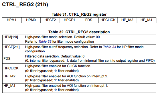

To solve you issue with the offset you can enable high pass filter for the interrupt threshold in CTRL_REG2. Then for the interrupt generation only relative change will be evaluated and any static value (offset, gravity) will be omitted.
In LIS2DE12 the threshold is only one and it is used for all three axis X, Y, Z. Is is not possible to set different threshold for each axis.
