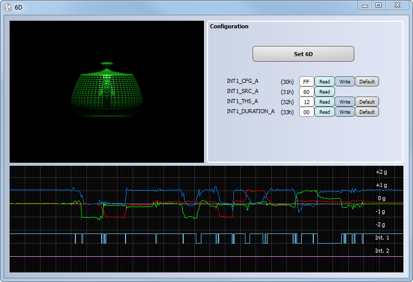

I'm using a LIS3DH accelerometer and I would like to detect the device orientation in the space. According to the specifications I could do this by means of the 6D orientation detection function, but I'm not getting any result. Can anyone tell me which is the correct setting of the registers of the LIS3DH in order to use the 6D orientation detection function?
Thanks to everybody who can help.
#lis3dh- Mark as New
‎2017-02-06 2:32 AM
Please read Chapter 6 - 6D/4D orientation detection in application note
https://my.st.com/resource/en/application_note/cd00290365.pdf
.You can see example of 6D orientation settings in following picture:

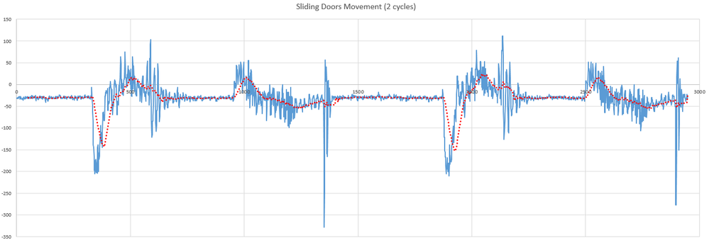

‎2017-02-07 3:14 AM
in principle it is possible to detect movement of sliding doors. The gravitation acceleration will be in perpendicular axis to the door movement, so it is not a problem.
I did quick test with automatic doors in our office (stick accelerometer on sliding door record the acceleration), here you can see the results:
I also did an analysis in excel and added moving average:
I can imagine that this could be used for example to make counter of door opening.

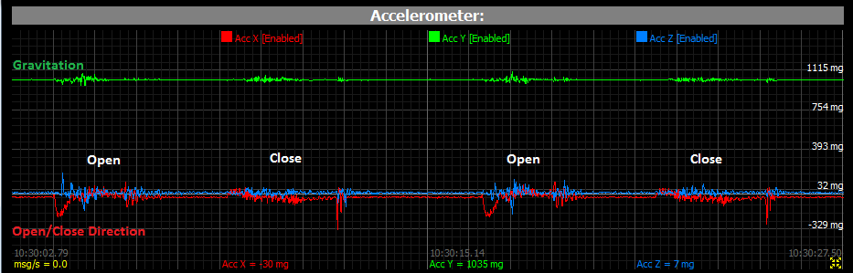

‎2017-08-14 4:11 AM
The decision if the sliding doors are opening or closing was made by the sign of the acceleration at the beginning of the movement.
According to sensor orientation the sign will be positive when opening and negative when closing or vice versa.
I recommend you to make a trial, record the acceleration data and make the analysis offline.
‎2017-08-15 11:50 PM
Thank you for your reply Miroslav!
Observed the scenario with LIS2DE12 accelerometer that the sign is negative when the door is closed, & it tends to be positive when the door is opened.
Please find the accelerometer readings observed with the different position of the device with 6D enabled.
