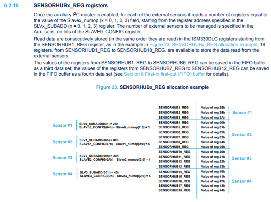

I'm currently trying out different configurations of the ISM330DLC sensor hub. Everything works as expected as long as I don't configure it to read more than 12 registers. If I do try to use more than 12 registers, I get some unexpected output in registers SENSORHUB13_REG to SENSORHUB18_REG. It seems like consecutive registers are set to identical values. This happens regardless of the type of sensor I'm trying to read.
For example, if I configure the sensor hub to read the same LPS22HH pressure sensor data (3 bytes pressure and 2 bytes temperature) three times (slaves 0-2), I would expect the sensor hub output registers to contain the same five bytes three times. However, for the second block of registers (13-18), this is not the case. Example:

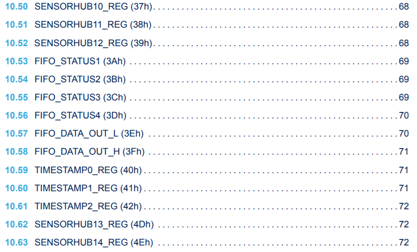

Hi Yannick @yath​ ,
The issue might be related to the fact that the the SENSORHUB13_REG is not consecutive to the SENSORHUB12_REG for the ISM330DLC? There is a jump from reg address 0x39 to reg address 0c4D, and if you are using the automatic increment you should take this into account.
0693W00000KaH3YQAV.pngSENSORHUB13_REG to SENSORHUB18_REG are "normal" register as SENSORHUB12_REG and below.

Hi Eleon,
thank you for your answer.
I am aware of the jump in register addresses. I am reading the two blocks separately: 1 to 12 in one go and 13 to 18 in one go. I have also tried to read all the registers individually, one after the other. The result was the same.

Hi Yannick @yath​ ,
did you check if you configured everything as described in the Application note AN5125, p.62?
