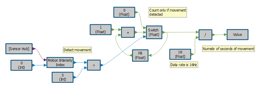

Is it possible to create a timer in Algobuilder that can be reset based on movement?
J-Damron
I would like to be able to create a timer that counts time elapsed during an activity and resets when the activity stops. Any suggestions on how to do this.
Miroslav BATEK
It can be done for example like this:
3 REPLIES 3
Miroslav BATEK
Eleon BORLINI
Hi @J-Damron​ ,
can you please check if Miroslav's useful suggestion is matching your application purpose?
-Eleon
Thank you Miroslav,
Your example is exactly what I needed to help me move forward with my project.
