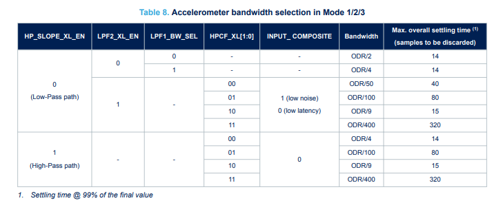

In ISM330DLC, is odr equals to smaling frequency? if not how to calculate the sampling frequency to calculate the FFT

Hi, the maximum bandwidth is equal to ODR/2 (if no filter is applied on the acquisition chain), as for Nyquist theorem.
You can fin the description of accelerometer max bandwidth (i.e. maximum detectable frequency) at p. 13/14 of the AN5125
