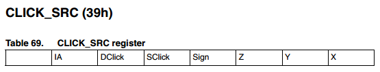

One more thing I would like to tell you that in the datasheet
of
DM00171283 there are no such bit like LIR in the click source register. So, how to use and configure that register for single click detection? Furthermore, my previous query still not be answered. I got the interrupt on single click but  I only click one time, interrupt got multiple time. Please provide proper guidance for that.

CLICK_THS ... 1 LSB = full scale/128 (in you case FS = 2g, CLICK_TSH = 0x05 ... 5 * 2g / 128 = 0.078g)
TIME_LIMIT ... 1 LSB = 1/ODR (in you case ODR = 100Hz,
TIME_LIMIT = 0x0D ... 13 * 1 / 100 = 0.13s)
Concerning the behavior you described, I think the X and Sign bits (values 0x09 or 0x01) in CLICK_SRC register are set immediately when the CLICK_THS is reached and the IA bit (value 0x51 or 0x59) is set if the value returns below it within a time window defined by the TIME_LIMIT register. So the IA bit has latency of TIM_LIMIT time.
Basically
 you can you can mask other bits in you program and the CLICK using only the IA bit in CLICK_SRC register or use the hardware interrupt signals.

Posted on July 19, 2017 at 15:36
The configuration and behavior seems OK to me.
Instead of continuous polling of CLICK_SRC register you can also use the hardware interrupt signal generated on INT1 or INT2 pin, if you have these signals connected to you microcontroller. In this case you can set the TIME_LATENCY and the interrupt will be kept active for this time (TIME_LATENCY) so it will mask multiple set of IA bit for single click. These multiple sets of IA bit are caused by bouncing of the device and this triggers the click detection multiple time. Another solution is to filter these multiple detection in software.
Concerning the region around the hardware, where the click is detected, it is really dependent on the board on which the sensor is soldered and mechanical construction of your device. You have to fine tune the sensitivity by the click threshold settings.
