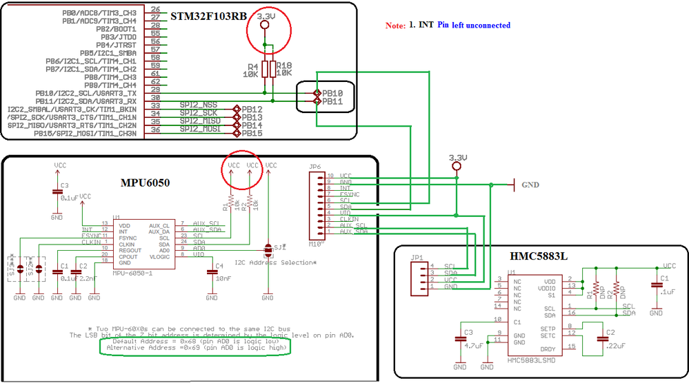

I have STM32-P103 board which uses STM32F103RB micro. I connected I2C sensors to I2C2 pins as shown below :
0690X000006050uQAA.png I use only 4 pins of the sensor, SCL, SDA, Vcc, GND.I have the following Initialization code & reading code:

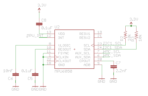

This code works fine for me as well as others. But now i use same files in another project which uses STM32F103RE micricontroller and sensor connected to I2C1 with 10k pull-ups( this time INT pin of MPU6050 connected to PB8, but not configured), rest of the things are same. 0690X00000604XiQAI.pngI also modified code to use I2C1.
#define MPU6050_I2C I2C1
#define MPU6050_I2C_RCC_Periph RCC_APB1Periph_I2C1
#define MPU6050_I2C_Port GPIOB
#define MPU6050_I2C_SCL_Pin GPIO_Pin_6
#define MPU6050_I2C_SDA_Pin GPIO_Pin_7
I call the I2C_BufferReadfunction just after initialization.Execution hangs at

jpeacock2399
Posted on July 23, 2012 at 16:18
On your schematic the VLOGIC input pin on the MPU6050 doesn't seem to be connected to the I2C supply voltage.  This might explain why the MPU6050 isn't responding to I2C commands.
  Jack Peacock
harinath
Posted on July 24, 2012 at 03:27
Hi Jack and others,
Jack & fm was right, It was my mistake that i did not connect VLOGIC pin to Supply.
http://www.sparkfun.com/
 breakout board schematic was the reason to commit to this mistake as it doesn't show connection of VLOGIC to supply(3.3V).
Once again thank you Jack & fm.

frankmeyer9
Posted on July 24, 2012 at 09:49
I hade a look at the MPU60x0 datasheet yesterday, and I agree with Jack.
The VLOGIC pin is listed as power supply for the logic block of the MPU6050, but for the MPU6050 only. According to the datasheet, this pin is not connected at the MPU6000 derivate.
I remember that a IMU300 which I have (from Invensense, like the MPU60x0) also has split power supply pins for analog and digital logic. That seems to be a speciality of Invensense.
