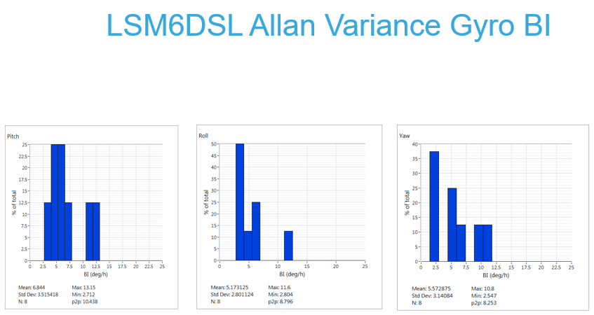

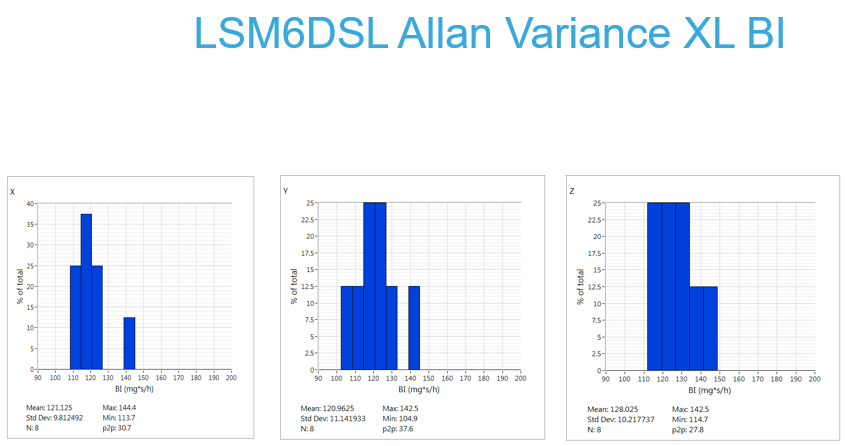

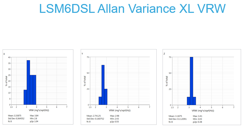

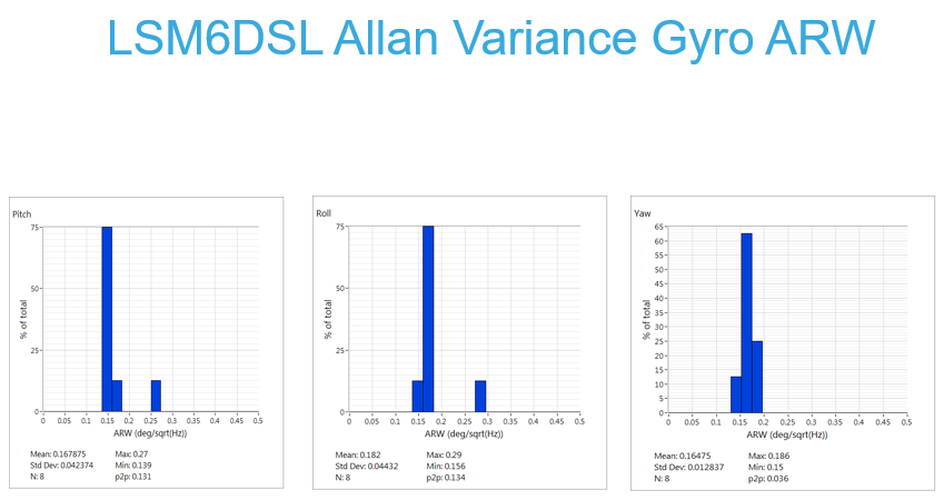

I would like to know some factors of LSM6DSL which is not mentioned in datasheet. 1. Bias Random Walk Noise standard deviation of Accelerometer & Gyroscope 3. Measurement noise standard deviation of Accelerometer & Gyroscope
SM.41

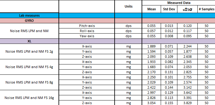

I need this parameters as am workin on an algorithm development which is based on IMU and camera. Please help me out.

HI @SM.4​ , the datasheet values usually refer to the parameter tested in production line
I believe you are referring to Angular / Velocity random walk and Bias Instability. In this case, you can find characterization values here below, for both Accelerometer and Gyro
You can find here below some characterization data on N.50 samples
