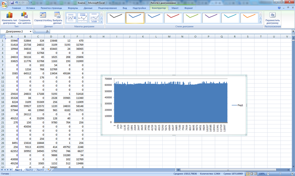

I use LSM9DS1 with STM32L433 and get strange data.
Vladimir Lobanov
Initialization code:

Can someone explain what I'm doing wrong?
8 REPLIES 8
T J
Lead
interpretation needs more information...
what is strange about the data ?
Vladimir Lobanov

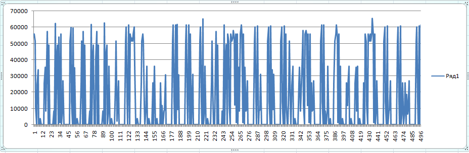

On all channels, data jumps from 0 to ~ 60000, although the accelerometer is at rest.
For example, X axys of gyro:0690X0000060QcxQAE.png
T J
Lead
ooo,
you have negative numbers
+ and - 0
like this:
5,4,3,2,1,0,0xffff,0xfffe these are negative numbers just next to zero

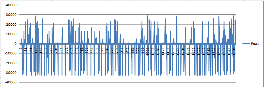

Vladimir Lobanov
Well, if we take into account the negative values, then the amplitudes are still large (although the accelerometer is stationary)0690X0000060RHNQA2.png
T J
Lead
do you have the bytes swapped ?

T J
Lead
do you have a noisy power supply ?
Vladimir Lobanov
I read Lo and Hi bytes and convert it to int16:
HAL_SPI_Receive(&hspi1, &data_temp[0], sizeof(data_temp[0]), 0x1000);
HAL_SPI_Receive(&hspi1, &data_temp[1], sizeof(data_temp[1]), 0x1000);
gyro_temp[0] = (int16_t) (((int16_t)data_temp[1] << 8) | data_temp[0]);
T J
Lead
I cant see the values, so how can I help...
are you sure the value are not reversed ?
or
gyro_temp[0] = (int16_t) (((int16_t)data_temp[0] << 8) | data_temp[1]);
