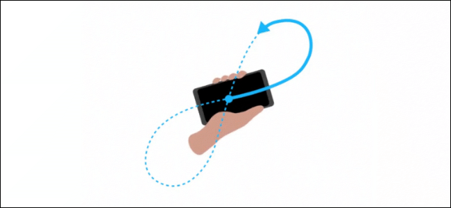

I changed the frequency of the updation of MotionFX to 20Hz just now, and the result did not changes. I wonder if it is because that the robot always move on the same plane, and the library need some data changing of the third axis to update the result?
Hi @RZHU.1​ ,
it could be the case... the suggested movement for the magnetometer calibration is on the 3 axis, for example as depicted below.
However, this complete calibration can be run at the beginning of the test, and the periodical calibration during the test can be avoided.

Thanks for your suggestion, I have changed my code and now it will only calibrate the magnetometer during the initialization stage, and the result of calibration is MMC_CALQSTATUSGOOD.
